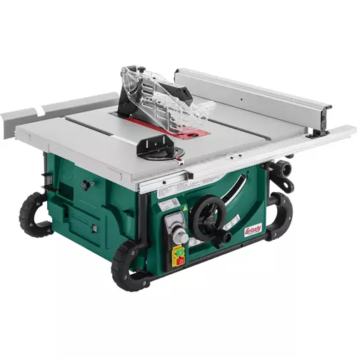

G0869 10" 2 HP Benchtop Table Saw
A jobsite saw designed for mobility and performance to improve productivity.
Recognized as the Best Value by Fine Woodworking Magazine. Product testers Fine Woodworking agree; the G0869 is the best value in portable table saws!
The powerful 2 HP motor of the G0869 10" 2 HP Benchtop Table Saw electronically manages torque and blade speed to direct more power to the motor when cutting into dense or thick wood. This helps prevent burning, yields a smoother cut, and saves energy.
Variable-speed controlling from 2000–4200 RPM allows you to cut other materials such as laminates and some plastics too!
The G0869 has a narrow-rip fence flips down to make room for push sticks when cutting thin or narrow material.
Macro and micro fence adjustments are quick and precise with the rack-and-pinion track system.
It takes just a few turns of the handwheel to adjust the blade to its full cutting height of 3-1/8".
The best jobsite table saw on the market at this price.
At just over 60 pounds, the G0869 has the mass and power to perform as well as larger, more costly saws, yet is light enough to easily move around the shop or to and from the job site.
The 26-3/8" x 22-1/4" table is made from aluminum which serves two purposes; it won’t rust outdoors or on wet jobsites and it is lighter/easier to move around.
With onboard storage for all the included accessories, such as the quick-change riving knife, push stick, miter gauge, and blade wrench, you'll have everything right at hand wherever the job takes you. Even if your shop is on the road!
A bonus feature is this saw’s ability to be converted into a disc sander when the optional T30883 Sanding Disc Kit is installed. You won’t find that option from our competitors!
