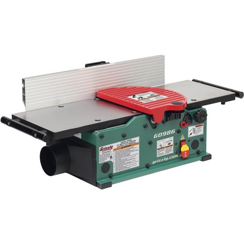

G0986 10" x 30" Benchtop Jointer with Spiral-Type Cutterhead
Extra-wide jointing capacity in a space-saving, heavy-duty machine.
Experience the convenience of portability with the capabilities of a full-sized jointer! With a large 10" capacity not found with other benchtop and entry-level jointers, you can face wide boards while preserving shop space.
The spiral-type cutterhead produces smooth, even workpiece surfaces with less tearout than other types.
Other benchtop jointers can't match the 54" table extension length – it reduces the chance of board flexing and increases cutting accuracy.
This wide-capacity jointer offers a 1-3/4 HP motor, with more power than any other benchtop to cut through dense hardwoods.
The solid cast-iron foundation keeps vibration down, so you can process boards with precise results.
Add this affordable jointer to your home workshop or small shop, and complete top quality edge jointing, tapering, beveling, and chamfering.
KEY FEATURES:
  • Spiral-Type Cutterhead: This simple to maintain cutterhead lets you quickly replace inserts as needed to maintain sharpness.
  • Built-in Table Extensions: Even with a small footprint, this jointer can handle boards up to 54" long when fully extended.
  • 24" Fence: Offers 4" of additional length compared to most other benchtop jointers.
  • Powerful 1-3/4 HP Motor: With the most robust motor you’ll encounter in a benchtop jointer, this model is a true workhorse.
  • Cast-Iron Infeed and Outfeed Tables:The heavy-duty construction guarantees years of durability.
  • Motor: 1-3/4 HP, single-phase, 12A
  • Maximum width of cut: 10"
  • Maximum depth of cut: 1/8"
  • Minimum workpiece length: 12"
  • Number of cuts per minute: 66,000
  • Cutterhead diameter: 2"
  • Cutterhead type: Spiral
  • Cutterhead speed: 11,000 RPM
  • Table size: 10-1/4 " x 30-3/4"
  • Fence size: 24" L x 7/8" W x 4-3/8" H
  • Dust port size: 4"
  • Footprint: 19 " x 13-1/2"
  • Space required for full range of movement: 54-1/2" x 22-1/2"
  • Overall dimensions: 34" W x 21-1/2" D x 13" H
  • Approximate shipping weight: 94 lbs.
