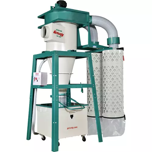

G0638 10 HP 3-Phase Cyclone Dust Collector
The cyclone dust collector for all your woodworking machines.
The G0638 features a whopping 4029 CFM capacity and can handle any large duct system with a static pressure loss less than 16.8".
The single square collection drum minimizes the downtime with a handle for hood raising when emptying dust and chips.
The noise-reducing exhaust mufflers keep the noise level below 90 dB.
The ramped air intake is so efficient, there is very little fine dust that makes it to the plastic filter bags.
With a 99.9% filter efficiency rating, essentially no dust escapes.
The perfect choice for large shops with multiple woodworking machines operating at the same time, all day long.
Replacement T24781 Canister Filters are available.
The T24876 replacement bags are for machines manufactured 10/2020 and after.
The H8469 replacement bags are for machines manufactured before 10/2020.
*This machine is prewired for 220V. We can rewire to 440V in a few days’ time for a fee. Please contact Grizzly Technical Support at (570) 546-9663 before placing your order.
  • Motor: 10 HP, 220V/440V* (prewired 240V), 3-phase, 30A/15A,
  • Minimum circuit size: 50A @ 220V, 20A @ 440V
  • Intake hole size: 12"
  • Impeller size: 18-1/2" steel radial fin
  • Airflow capacity: 4029 CFM @ 2.51" SP
  • Maximum static pressure: 16.8"
  • Filtration: 0.2-2 micron
  • Filter surface area: 398 sq. ft.
  • Collection drum: Steel, 55 gallons
  • Sound level: 87-90 dB
  • Footprint: 79-1/2" x 51"
  • Overall dimensions: 76-3/4" L x 60-1/2" W x 139-3/8" H
  • Approximate shipping weight: 1216 lbs.
  • 99.9% Filter efficiency at 0.2-2 microns
  • Ramped inlet maximizes dust flow into the collection drums
  • Steel collection drum has casters for easy dust disposal
  • Remote controlled magnetic switch
  • Standard equipment mufflers reduce noise level without reducing air flow
  • Blower and barrel rotate 360° for inlet and outlet positioning
  • Includes stand
