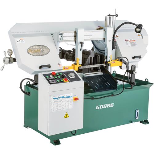

G0886 12" x 14" 3 HP 3-Phase Auto Metal-Cutting Bandsaw
Increase your metal-cutting productivity with fully automatic feeding, cutting, and lifting.
With an impressive 12" x 14" capacity and powerful 3 HP, 3-phase motor, the G0886 has the capabilities to process some serious material.
The hydraulic vise uses a built-in power feed system to feed material to the desired length determined by a fine tunable sensor.
Simply set your cut length, set the desired number of cuts and blade speed, load your material, and press start-the G0886 does the rest!
The workhorse also features a built-in 6-1/2-gallon coolant tank and full wrap catch basin to ensure coolant stays where it belongs.
Perfect for cutting heavy steel or aluminum stock, you can quick and easily adjust downward feed rate to help maximize blade life. This saw truly does it all!
Stock must be at least 1" tall for auto feed to work.
For a full range of replacement blades for the G0886, shop here.
  • Motor: 3HP, 220V, 3-phase, 8A
  • Blade size: 155-1/2" x 1-3/8"
  • Blade speeds: 92, 161, 236, 338 FPM
  • Cutting capacities:
    • 90° Round: 11-13/16"
    • 90° Rectangular: 11-13/16" x 14"
  • Vise jaw height: 6-11/16"
  • Vise depth: 14"
  • Floor to table height: 27"
  • Footprint: 56" x 28"
  • Overall dimensions: 83" W x 43" D x 55" H
  • Approximate shipping weight: 1800 lbs.
  • Proximity sensor head
  • Auto and manual cutting mode
  • Hydraulic headstock lifting
  • Power locking vise
  • Drop chute for cut material
  • Part counting screen
  • 6-1/2-Gallon coolant tank
  • Dual coolant nozzles
  • Built-in work light
  • Adjustable lifting stop switch
