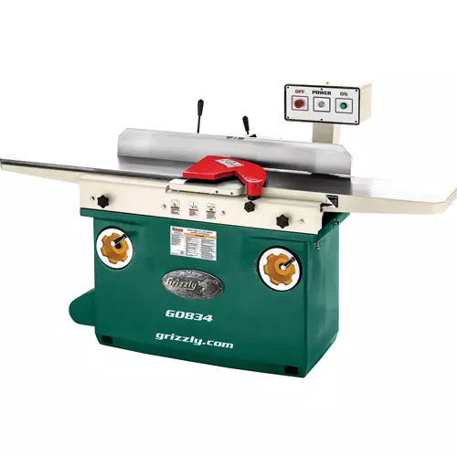

G0834 12" x 84" 5 HP Parallelogram Jointer
Maximize your woodworking potential with spiral cutterhead jointing.
With 84" of precision-ground cast-iron tables and a solid cast-iron stand, the G0834 12" Parallelogram Jointer weighs in at over half a ton! All that mass minimizes vibration and optimizes accuracy.
A burly 5 HP, 230V, single-phase motor powers the 8-row spiral cutterhead with 96 indexable carbide inserts. Carbide inserts hold their edge much longer than the high-speed steel of the straight knives and they are easily replaced or rotated should they become nicked.
Spiral cutterheads provide a smoother finish, reduce tearout, operate quieter, have longer knife life, and require less horsepower, making them a superior choice for serious woodworkers.
The G0834 features precise parallelogram table adjustment with easy-to-reach handwheels. With the parallelogram table setup, you get more opportunity for fine adjustment of the infeed table and the outfeed table for perfect alignment.
The center-mounted, 47" L x 5-3/8" H fence assists with accurate edge-jointing. It has stops at 45°, 90°, and 135° and comes with rack-and-pinion lateral adjustment.
The H9893 replacement inserts are available when the stock inserts get dull.
The G0834 manual was written by our U.S.-based Technical Documentation Department and is packed with useful information.
  • Motor: 5 HP, 230V, single-phase, 19A
  • Maximum width of cut: 12"
  • Maximum depth of cut: 1/8"
  • Maximum rabbeting depth: 1/2"
  • Cutterhead diameter: 3-7/8"
  • Cutterhead type: 8-row spiral with 96 inserts
  • Insert size, type: 15 x 15 x 2.5mm, indexable carbide
  • Cutterhead speed: 4950 RPM
  • Table size: 84" x 12-3/4"
  • Fence size: 47" L x 5-3/8" H
  • Minimum stock length: 14"
  • Dust port size: 5"
  • Footprint: 41" x 19-1/2"
  • Overall dimensions: 84" W x 39" D x 47" H
  • Approximate shipping weight: 1278 lbs.
  • Parallelogram tables with handwheel adjustment
  • Precision-ground cast-iron tables
  • Rabbeting table
  • Heavy-duty center-mounted fence with angle gauge
  • Pedestal-mounted switch for easy access
  • Solid cabinet stand
  • V-belt drive
