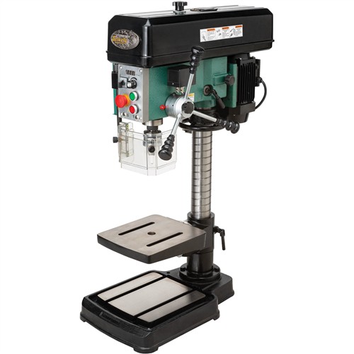

T33962 16" Benchtop Variable-Speed Tapping Drill Press
A specialized drill press with tapping capability to streamline threading processes.
This benchtop drill press provides the additional functionality you need to cut your desired thread patterns, offering a 1/2" tapping capacity.
With two variable-speed spindle speed ranges and a digital readout, it is simple to adjust the speed based on your specific needs. The spindle has auto reverse for tapping functions.
The 360° headstock makes positioning easy, headstock height is easily adjustable, and the cast-iron base gives stability during use.
The Class II laser gives the precision required for every project by preventing alignment mistakes – no guesswork involved.
A built-in LED work light below the headstock of this variable-speed drill press provides helpful extra illumination.
Rack-and-pinion table elevation control allows for effortless, precise adjustments based on your material thickness.
The square chuck safety guard comes with a micro switch that shuts the drill press off if the guard is opened. The clear chip guard protects the user from debris.
It also offers a belt cover safety switch for additional safety during operation.
