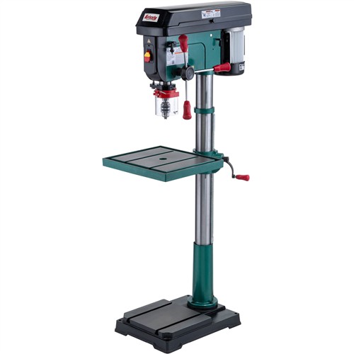

T33904 20" Floor Drill Press with LED and Laser
An affordable drill press with unique features and precision capabilities to maximize productivity.
This 20" floor option is a perfect choice for a beginner or an experienced hobbyist looking for an economical floor drill press.
Whether you are countersinking, reaming, tapping, or performing other drilling steps, this press will be a valuable addition to your shop.
The 20" swing allows for working on larger projects compared to 14" and 17" drill presses.
The 1-1/4 HP motor powers the spindle through twelve speeds from 210 to 3020 RPM and through 1" mild steel.
Use the crank handle to adjust the table vertically as needed for each project; the rack-and-pinion motion is smooth which makes adjusting the table easy.
The LED light provides essential support during all drilling processes, increasing visibility to ensure accuracy every time.
With a laser-line guide you can avoid costly errors during the drilling process and prevent wasted materials.
The push-button, heavy metal spindle depth stop allows for effortless adjustments and repeatable drilling.
Durable floor model drill press with the options you need to create eye-catching and functional projects.
  • Motor: 1-1/4 HP, 120V, single-phase, 13A
  • Swing: 20"
  • Spindle taper: MT#4
  • Spindle travel: 4-1/2"
  • Spindle speeds: 12, 210–3020 RPM
  • Drill chuck: 1/8"–5/8", JT3
  • Drilling capacity: 1" mild steel
  • Max. distance from spindle to table: 28-5/8"
  • Table dimensions: 18-1/2" x 16-5/16"
  • Table tilt: 45° left/right
  • Table swivel around column: 360°
  • Footprint: 22-1/2" x 16-1/2"
  • Overall dimensions: 18-1/2" W x 33" D x 67-1/2" H
  • Approximate shipping weight: 257 lbs.
  • Crank handle-operated rack-and-pinion vertical table movement
  • Built-in LED light
  • Laser line guide
  • Push-button spindle depth stop
  • Heavy-duty construction
We offer U.S.-based customer service and technical support to get your questions answered and help keep your equipment running in top condition. And to ensure your satisfaction, the T33904 comes with a 1-year warranty.
