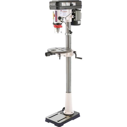

W1848 13-1/4" Oscillating Floor Drill Press
With the oscillating motion, this is much more than just a floor drill press.
The Shop Fox W1848 13-1/4" Oscillating Floor Drill Press can be used for efficient contour sanding in addition to traditional drilling.
Converting from drilling operations to sanding operations takes a matter of seconds with just a few tool-free steps.
The W1848 is fitted with a 3/64" to 5/8" JT33 keyed drill chuck, offers up to 3-1/8" of travel and a drilling capacity of 5/8" through mild steel.
With the oscillating feature, the oscillating stroke length is 3/4".
The 12-3/8" diameter, round table allows for drilling and surface sanding at different angles as it tilts 90° in both directions.
The table has a clearance hole for use while sanding. This clever design incorporates a 2-1/2" dust collection port so that sanding is less messy.
