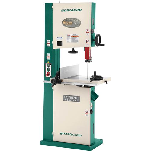

G0514X2B 19" 3 HP Extreme-Series Wood Bandsaw w/ Motor Brake
A fully-featured 19" bandsaw with serious capabilities.
The G0514X2B 19" 3 HP Extreme-Series Bandsaw is ready to handle your woodworking projects.
The table will tilt 5° left and 45° right to provide a wide range of cutting options. The positive stop allows thew table to be quickly and accurately returned to 0°.
This saw features a rack-and-pinion table tilt control with extra table support and an innovative resaw fence. The cast-iron table trunnions add additional weight for greater stability.
The electronic motor brake stops the blade in approximately 3 seconds—all with the simple push of a switch.
A clear blade tracking window allows you to observe the blade as you adjust the tracking controls to center the blade. For a full range replacement and resaw blades for the G0514X2B, shop here.
Additional features include a heavy-duty miter gauge, dual 4" dust ports to suck up all the sawdust, and double ball-bearing blade guides that are usually found on machines costing much more.
The G0514X2B manual was written by our U.S.-based Technical Documentation Department and is packed with useful information. The complete and easy-to-read manual provides full instructions on how to assemble and maintain your bandsaw.
