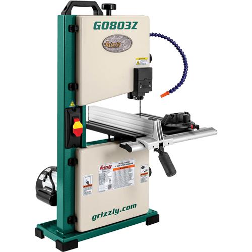

G0803Z 9" Benchtop Bandsaw with Laser Guide
Portability and superior cutting performance with enough power to not bog down on hardwoods.
The Grizzly G0803 that was awarded as Top Value by Wood Magazine for its combination of features including an efficient 1/3 HP motor, heavy-duty feel, and portability, has been upgraded with a new laser guidance system and adjustable blower to provide superior cutting visibility.
The G0803Z 9" Benchtop Bandsaw with Laser Guide features a 62-inch blade and accepts blades from 1/8" to 3/8" wide. It can cut pieces up to 3-5/8" high and has enough power to cut through green woods and other dense materials.
The rack-and-pinion table tilt system makes it easy to cut beveled edges. The blade guard is also rack-and-pinion making adjustment an easy one-handed operation.
The quality design and construction of the G0803Z assures easy, accurate cuts including fine detailed cuts without the vibration found in other benchtop models.
Blade tensioning is quick with a rotation of a lever to release or re-tension the blade. Blade tracking adjustments are simple as turning the respective blade adjustment knob. For a full range replacement and resaw blades for the G0803Z, shop here.
The small footprint and top handle make moving the bandsaw around your workspace easier. The saw weighs less than 50 pounds, so you can also effortlessly set it up and store it away between uses.
The best combination of price and performance of 9" bandsaws.
Because of the compact size, the bandsaw will arrive about 80% assembled. It will include a user manual written by our U.S.-based Technical Documentation Department making set up a breeze.
