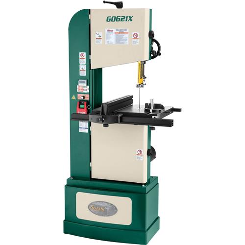

G0621X 13-1/2" 1-1/4 HP Vertical Wood/Metal Bandsaw
Affordable versatility not found on any saw in its class.
The G0621X 13-1/2" 1-1/4 HP Vertical Wood/Metal Bandsaw has the rugged functionality of two machines in one.
This bandsaw features a variable-speed drive which allows you to slow the blade down for cutting metal and speed the blade up for cutting wood.
Adjusting the speed of the blade is as simple as turning a dial. The speed is displayed in FPM on a digital display.
Blade changes are fast and easy with the quick-release blade feature. For a full range replacement and resaw blades for the G0621X, shop here.
The precision-ground cast-iron table tilts 45° right and 5° to the left.
The three ball-bearing rollers on the upper and lower blade guide assemblies are easy to adjust.
  • Required power source: 220V, single-phase, min. 15A circuit
  • Motor: 1-1/4 HP, 220V
  • Throat (max. width left of blade): 13-1/2"
  • Resaw capacity: 10"
  • Blade length: 108"
  • Blade size range: 1/8"–1"
  • Blade size: 108-1/8"
  • Included wood blade size: 108" x 3/8" x 6 TPI
  • Blade speed: Variable, 150–3000 FPM
  • Table tilt: 45° right, 5° left
  • Floor to table height: 38-1/2"
  • Table size: 16" x 20"
  • Footprint: 27" x 15"
  • Overall dimensions: 30" W x 30" D x 72-1/2" H
  • Approximate shipping weight: 277 lbs.
  • Left and right table tilting control
  • Upper and lower blade guides
  • Rack-and-pinion adjustment on upper blade guide support
  • Precision-ground, cast-iron table
  • Fully- balanced, cast-iron wheels with rubber tires
  • Quick-release blade tension
  • Steel guide blocks
  • 2-1/2" universal dust port
  • Rip fence and miter gauge
Note: The G0621X does not come with a plug. The recommended plug type is 6-15.
Additional Note: As an option, the T34579 110V Conversion Kit transforms the power supply requirements of the G0621X from 220V to 110V.
