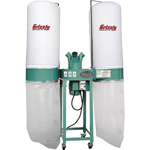

G0671 4 HP Dust Collector
The perfect multiple machine dust collector for shops without tall ceilings.
The G0671 4 HP Dust Collector can connect to four simultaneously running woodworking machines in a large-sized shop.
Static pressure is produced by the 14-1/2" steel impeller to move the wood chips into the collector.
The G0671 has an air suction capacity of 3552 CFM and has a max static pressure of 13.5" at 0 CFM.
2.5-micron upper filter top bags capture the fine dust particles; plastic bags catch the rest.
The steel base has been fitted with casters to allow you to move this unit easily.

  • Motor: 4 HP, 220V, single-phase, 26A
  • Air suction capacity: 3552 CFM
  • Maximum static pressure: 13.5"
  • Impeller: 14-1/2" balanced steel, radial fin
  • Filtration rating: 2.5-micron
  • Intake port with manifold: 4 x 4"
  • Intake port without manifold: 10"
  • Simultaneous machine collection capacity: 4
  • Collection bag capacity: 24 cubic feet
  • Bottom bag material: plastic
  • Bottom bag size: 23-5/8" x 54"
  • Overal dimensions: 73-7/8" x 31-3/8" x 106-1/8"
  • Approximate shipping weight: 306 lbs.
  • 2.5-Micron upper bag filtration on top, plastic bag on bottom
  • 14-1/2" Balanced steel, radial fin impeller
  • Heavy-duty steel stand with 3" casters and brakes
  • Sturdy collection bags with 24 cu. ft. total capacity
  • Four port intake manifold for even distribution to collection bags
