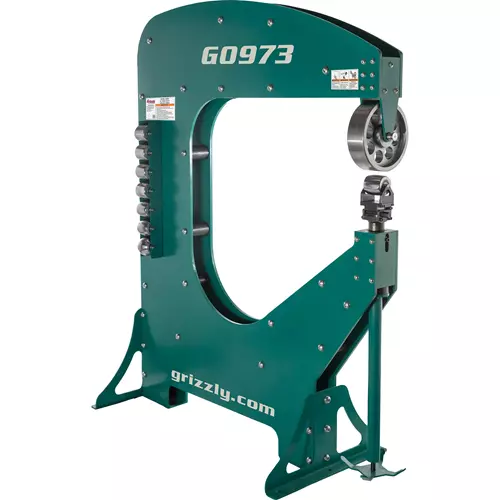

G0973 40" Heavy-Duty English Wheel
An efficient English wheel for high-capacity, high-tolerance metal-shaping applications.
Create smooth, gradual curves in steel and aluminum with this specialized tool that offers a 40" throat capacity for extensive workpiece clearance.
This English wheel offers a highly rigid frame to ensure consistency in the shaping process and long-term usability.
The quick-release lower anvil provides essential support to the workpiece to prevent imperfections caused by slippage.
A locking ram allows you to secure the upper wheel in a fixed position.
This heavy-duty English wheel comes equipped with eight lower anvils to coincide with your specific project requirements.
A rack is frame-mounted for convenient storage of anvils when not in use.
  • Throat capacity: 40"
  • Mild steel capacity: 16-Gauge
  • Aluminum capacity: 14-Gauge
  • Upper wheel diameter: 10"
  • Number of lower anvil wheels: 8
  • Lower anvil wheel diameters: (7) 3", (1) 3-1/2"
  • Footprint: 31-1/2" x 49"
  • Overall dimensions: 35-1/2" W x 61" D x 73-1/2" H
  • Approximate shipping weight: 1213 lbs.
  • Quick-release lower anvil
  • Locking ram
  • Assorted lower shaping anvil wheels. Radius: 2", 4", 6", 8", 12" 24", 36", and flat
  • Auxiliary anvil wheel storage rack mounted to frame
  • 1-year limited warranty
