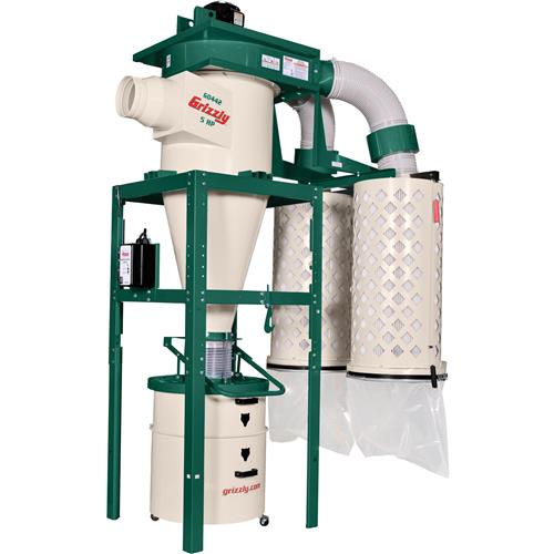

G0442 5 HP Cyclone Dust Collector
A properly powered single-phase cyclone dust collector.
Cyclonic action of the G0442 5 HP Cyclone Dust Collector separates the heavy dust particles from the fine particles and drops them into the 55-gallon steel drum.
The fine dust travels past the 16" diameter impeller and is then trapped by a cartridge filter made of spun-bond polyester that filters 99.9% of particles from 0.2 to 2 microns in size.
The cartridge filter is pleated to provide 226 square feet of surface area for efficient air movement and a clear plastic bag collects the fine cake that shakes off the filter for consistent dust collector performance.
Casters mounted to the drum also make disposal of the larger chips and dust as easy as it gets.
Other features include: a vertical motor support for reduced vibration, thick walled 11-gauge steel blower housing, 14-gauge steel cyclone body, 360° blower rotation for easy connection to a duct system, TEFC Class "F" motor, filter cleaning devise for optimum performance, and a magnetic switch with remote control.
