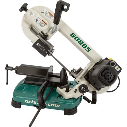

G0885 5" Portable Metal Cutting Bandsaw
A metal cutting bandsaw perfect for use on your benchtop or at the job site.
The G0885 5" Portable Metal Cutting Bandsaw has 4-3/4" round and 5" x 4-3/4" rectangular cutting capacities.
The powerful 1/2 HP motor makes short work of wrought iron, rectangular steel tubing with a heavy wall thickness, or solid aluminum block, making it perfect for any ferrous and non-ferrous metals you might use for basic fabrication at the job site.
The compact, 5" Portable Metal Cutting Bandsaw offers smooth variable-speed adjustability with speeds from 100 to 260 FPM, so you can easily adjust operation to make the best possible cut for any material without excessive wear on your blade.
Electronic load sensing increases torque output to maintain constant blade speed, and advanced thermal overload protection with soft-start feature protects the motor.
The handle with On/Off trigger switch provides easy leverage and cut control, and the built-in vise holds your workpiece firmly. The swing away stop rod allows for repeated, accurate cuts up to 10".
The headstock can be adjusted to cut any angle, from a straight 90° cut-off to a 60° angle, by loosening the angle lock handle. The angle of the cut can be read using the scale on top of the saw base.
All this in a lightweight, portable package at a price that is hundreds less than you will find elsewhere.
For a full range of replacement blades for the G0885, shop here.
