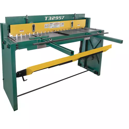

T32957 52" Sheet Metal Shear
Cut your work down to size with this heavy-duty shear.
The T32957 Sheet Metal Shear cuts up to 52" wide with all the precision you'd expect from a machine this size.
Features a heavy cast-iron body with foot control, a precision-ground steel blade, a spring-activated hold down, and a safety guard.
The front stop and angle guide are quickly adjusted by wing nuts on the top of the stops.
The rear extension arms have micro-adjusting stops that allow you to fine tune your cut length.
Also includes table gauges and front extension arms for those really large sheet metal jobs.
