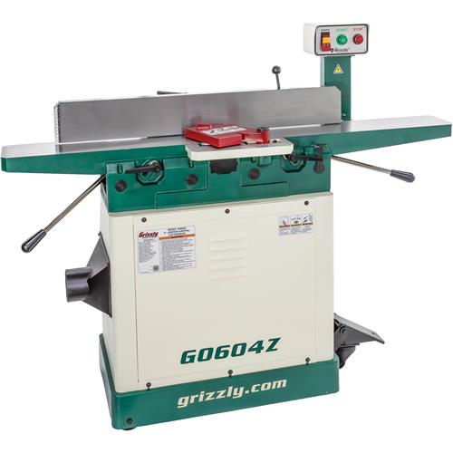

G0604Z 6" x 55" Parallelogram Jointer with Spiral Cutterhead
Step into the realm of precision woodworking with the G0604Z 6" Jointer, your gateway to impeccable cutting results marked by accuracy and uniformity.
4-Row Spiral Cutterhead: Get better finishes, smoother operation, and easier maintenance than straight-knife cutterheads. 30 razor-sharp indexable carbide inserts can be rotated up to 3 times to expose a new sharp edge.
Parallelogram Table Adjustment: The versatile parallelogram table adjustment mechanism moves with four points of contact. This makes table adjustments smoother and more precise, even with long and heavy cast-iron tables. It also keeps the tables closer to the cutter, which adds a degree of safety during operation.
Long Infeed Table and Center-Mounted Fence: Achieve perfectly straight cuts effortlessly with the extra-long infeed table and a 5" tall, center-mounted fence.
User-Friendly Controls: The precision-ground cast-iron infeed and outfeed tables feature lever control for easy table height adjustment and a depth gauge for precise referencing.
Built for Mobility and Storage: This 6" jointer includes a cabinet stand that not only provides valuable storage but also comes with a built-in mobile base for convenient transport within your workshop.
Effective Dust Collection: A 4" dust port with a built-in dust chute is ready for easy attachment to a dust collector or shop vacuum, keeping your workspace clean.
Efficient Power Transmission: The V-belt drive system ensures exceptional power transmission, offering stability and the necessary torque for tackling tough materials.
When the time comes, the H7319 are the 14mm x 14mm x 2.0mm replacement inserts needed.
While this machine is prewired to operate on 120-volt power, it can be converted to 240-volt. Voltage conversion must be performed by an electrician, requires part numbers P0604Z136X, P0604Z137X, P0604Z142X, and P0604Z237X, and installing a 6-15 plug.
The G0604Z manual was written by our U.S.-based Technical Documentation Department and is packed with useful information.
