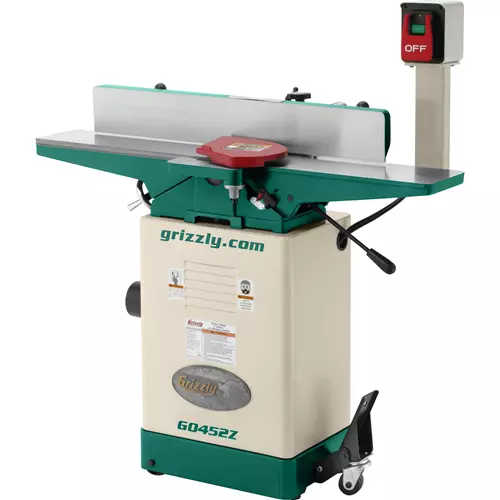

Grizzly G0452Z - 6" x 46" Jointer w/ Spiral Cutterhead

  • Motor: 1.5 HP
  • Table size: 46 in. x 7-1/2 in.
  • Table type: Precision Ground Cast Iron
  • Table adjustment: Dovetailed Ways
  • Cutterhead type: Spiral
  • Cutterhead diameter: 2-1/2 in.
  • Max depth of cut: 1/8 in.
  • Fence size: 5 in. x 35 in.
  • Shipping weight: 266 lbs.

  • Motor: 1-1/2 HP, 120V/240V (prewired 120V), single-phase, 15A/7.5A
  • Maximum width of cut: 6"
  • Maximum depth of cut: 1/8"
  • Maximum rabbeting depth: 1/2"
  • Cutterhead diameter: 2-1/2"
  • Cutterhead type: 4-row spiral with 32 inserts
  • Insert size, type: 14 x 14 x 2mm, indexable carbide
  • Cutterhead speed: 4800 RPM
  • Table size: 7-1/2" x 46"
  • Fence size: 35" L x 5" H
  • Minimum stock length: 8"
  • Dust port size: 4"
  • Footprint: 18" x 13-1/2"
  • Overall dimensions: 46" W x 27-1/2" D x 49" H
  • Approx. shipping weight: 266 lbs.
  • Precision-ground cast-iron tables and fence
  • Handwheel-adjusted outfeed table
  • Lever-adjusted infeed table with depth gauge
  • Rabbeting table
  • Pedestal-mounted switch with large shut-off paddle
  • Center-mounted fence with rack-and-pinion adjustment
  • Fence stops at 45°, 90°, and 135°
  • Pair of push blocks included
