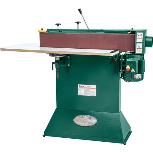

G0512 6" x 80" Edge Sander with Wrap-Around Table
Edge sanding at its finest!
The G0512 Edge Sander was developed for those projects that require a large support area and have long straight sides or curves.
The specially designed 2-1/8" diameter roller allows you to get into tighter radius projects like guitar bodies, curved chair legs, etc.
The table is supported in four positions to eliminate sagging and to provide a stable base while working.
The quick-release belt tension lever allows fast belt changes.
A full range of replacement belts are available.
The G0512 manual was written by our U.S.-based Documentation Department is packed with useful information. The complete and easy-to-read manual makes it easier to assemble and maintain your sander.
  • Motor: 1-1/2 HP, 110V/220V (prewired 220V), single-phase, 20A/10A
  • Sanding belt speed: 1800 FPM
  • Sanding belt size: 6" x 80"
  • Table size: 23-5/8" x 42-1/4"
  • Table height: 33"–38"
  • Platen: 6-1/4" x 31-1/2", graphite-coated
  • Rubber idler roller: 2-1/8"
  • Drive roller: 4-1/2", cast aluminum
  • Footprint: 32" L x 14-1/2" W
  • Overall size: 52-1/2" W x 24" D x 48-3/4" H
  • Approximate shipping weight: 251 lbs.
  • Paddle safety switch with removable key
  • Direct-drive power transfer
  • Shielded and permanently lubricated ball bearings
  • Welded-steel powder-coated base
  • Composite with plastic laminate surface table
  • Extended sanding surface
  • Work stop
  • 4" Dust port
  • Quick-release belt tension lever
  • Belt tracking and tension adjustment
  • Handwheel table height adjustment
