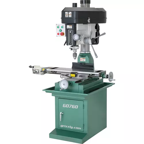

G0760 8" x 29" 2 HP Mill/Drill with Stand and Power Feed
A heavy-duty combination machine ready for high production.
The G0760 8" x 29" 2 HP Mill/Drill has a 2 HP motor and enough table space to make quick work of just about any machining job you can throw at it.
The X-axis table power feed provides precision powered longitudinal table movement with adjustable limit stops for a preset range of motion.
The G0760 features an R-8 spindle and includes an R-8 drill chuck arbor and MT#3 drill chuck. Included are two adapters that will allow the use of MT#3 and MT#2 tooling.

  • Motor: 2 HP, 110V/220V* (prewired 220V), single-phase. 17.8A/8.6A
  • Minimum circuit size: 20A @ 120V, 15A @ 240V
  • Spindle taper: R-8
  • Spindle speeds: 12, 140–2436 RPM
  • Max. distance spindle to column: 7-3/4"
  • Max. distance spindle to table: 17-5/16"
  • Spindle travel: 4-11/16"
  • Drilling capacity for steel: 1"
  • Drilling capacity for cast-iron: 1-3/16"
  • Table size: 8-1/4" x 28-3/4"
  • Longitudinal travel: 19-11/16"
  • Cross travel: 7-1/2"
  • T-Slots: 3 @ 2-1/2" centers, 5/8" wide
  • Overall dimensions: 47" W x 40-1/2" D x 66-1/2" H
  • Approximate shipping weight: 848 lbs.
  • Calibrated depth stop
  • Fine feed downfeed control, graduated in 0.001"
  • Coolant trough
  • Variable-speed longitudinal power feed
  • Quill moves 0.108" per revolution of fine feed handwheel
  • Table moves 0.100" per revolution of handwheel
  • Stand with storage shelves
