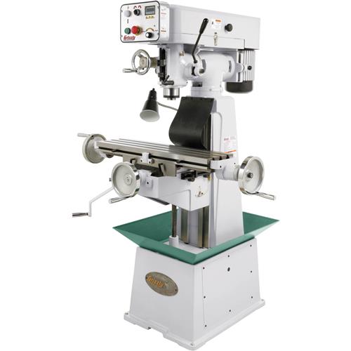

G0678 8" x 30" 1-1/2 HP Variable-Speed Vertical Mill
Equip your shop with a vertical mill for precision machining.
The G0678 Vertical Mill is engineered for efficiency. From its user-friendly controls to its powerful motor, this machine helps you complete your projects faster and with greater ease. Designed for the home shop, school, or production environment, this machine offers a range of features that enhance your machining capabilities:
  • Variable Frequency Drive: VFD for smooth, high-torque variable speed from 200 to 2250 RPM using single-phase power.
  • Versatility and Precision: The tilting head rotates 90° from left to right and expands your machining options. The fine downfeed, graduated scale, and table travelling on dovetail ways ensure accurate and controlled cuts.
  • Built for Productivity: The robust construction, including a turret-style column that rotates 360° around the column, ensures lasting performance and supports even the most demanding projects.
  • Enhanced Maintenance: One-shot lubrication simplifies maintenance and minimizes downtime, allowing you to focus on your work with greater efficiency.
Additional features include a reversing switch, fold-up safety handles, and adjustable travel stops on X- and Y-axes. Experience the difference with the G0678 Vertical Mill.
  • Required power source: 220V, single-phase, min. 15A circuit
  • Motor: 1-1/2 HP, 220V
  • Spindle taper: R-8
  • Spindle travel: 3-1/2"
  • Spindle speed: Variable, 200–2250 RPM
  • Table size: 8" x 30"
  • Table travel (longitudinal): 18"
  • Table travel (cross): 7-1/2"
  • Knee travel (vertical): 17-3/4"
  • Max. dist. spindle to table: 20"
  • Column swivel: 360°
  • T-slots: Three 1/2" slots, 2-3/16" on center
  • Footprint: 19" x 26"
  • Overall dimensions: 40-1/2" W x 42-3/4" D x 67" H
  • Approximate shipping weight: 1210 lbs.
