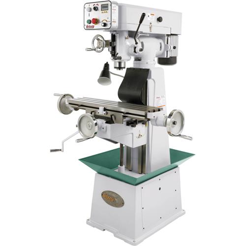

G0678 8" x 30" 1-1/2 HP Variable-Speed Vertical Mill
Equip your shop with a vertical mill for precision machining.
The G0678 Vertical Mill is engineered for efficiency. From its user-friendly controls to its powerful motor, this machine helps you complete your projects faster and with greater ease. Designed for the home shop, school, or production environment, this machine offers a range of features that enhance your machining capabilities:
  • Variable Frequency Drive: VFD for smooth, high-torque variable speed from 200 to 2250 RPM using single-phase power.
  • Versatility and Precision: The tilting head rotates 90° from left to right and expands your machining options. The fine downfeed, graduated scale, and table travelling on dovetail ways ensure accurate and controlled cuts.
  • Built for Productivity: The robust construction, including a turret-style column that rotates 360° around the column, ensures lasting performance and supports even the most demanding projects.
  • Enhanced Maintenance: One-shot lubrication simplifies maintenance and minimizes downtime, allowing you to focus on your work with greater efficiency.
Additional features include a reversing switch, fold-up safety handles, and adjustable travel stops on X- and Y-axes. Experience the difference with the G0678 Vertical Mill.
