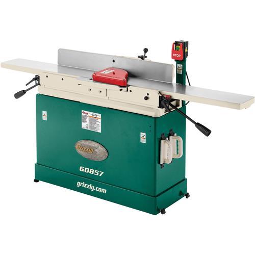

G0857 8" x 76" Parallelogram Jointer w/ Mobile Base
A precise, powerful workhorse for your home shop, with a convenient mobile base built in.
With four points of contact, parallelogram tables naturally maintain perfect alignment between the infeed and outfeed tables. This allows for consistently flat and parallel surfaces.
The G0857 Parallelogram Jointer tables feature arched table travel, keeping each table close to the cutter, and adding an additional degree of safety during operation.
Setting cut depth is a breeze for traditional jointing or rabbeting with the infeed and outfeed adjustment levers.
The precision-ground, cast-iron infeed table is 40" which is helpful for surfacing longer stock.
The H4982 replacement HSS blades are available when the stock blades get dull. HSS (high-speed steel) has been heat treated for hardness and wear resistance, which keeps a sharp edge longer than other carbon steels.
An upgraded V-helical cutter head of the T32058 is also available for cleaner cuts with no tearout.
The G0857 manual was written by our U.S.-based Technical Documentation Department and is packed with useful information. The complete and easy-to-read manual makes it easier to assemble and maintain your planer.
CSA certified
  • Motor: 3 HP, 230V, single-phase, 12A
  • Maximum width of cut: 8"
  • Maximum depth of cut: 1/8"
  • Maximum rabbeting depth: 1/2"
  • Cutterhead diameter: 3-1/16"
  • Cutterhead type: 4-knife
  • Knife size: 8" x 3/4" x 1/8"
  • Cutterhead speed: 5500 RPM
  • Table size: 8" x 76"
  • Fence size: 38" x 4-1/2"
  • Minimum stock length: 10"
  • Dust port size: 4"
  • Footprint: 16" x 40"
  • Overall dimensions: 76" W x 25" D x 41-1/2" H
  • Approximate shipping weight: 484 lbs.
  • Parallelogram tables with lever adjustment and depth scale
  • Extra-long 40" infeed table
  • Built-in mobile base with internally-mounted, non-directional casters
  • Center-mounted cast-iron fence with rack & pinion adjustment and angle gauge
  • Fence stops at 45°, 90°, and 135°
  • Pedestal-mounted power switch with large STOP paddle
  • 1-year limited warranty
