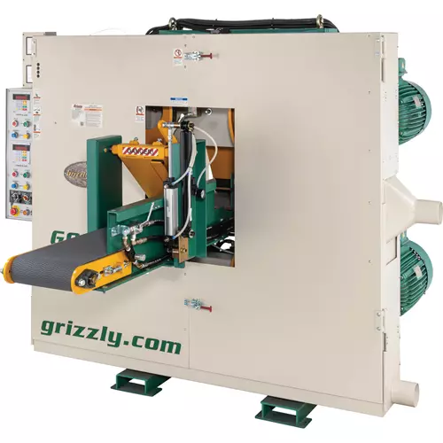

G0919 Twin Head/Dual Blade Resaw Bandsaw
For any resaw operation or large-scale production facility.
The G0919 Twin-Head Horizontal Resaw Bandsaw makes quick work of rough-sawn material with two massive 20 HP main motors.
The dual 168" x 2" blades slice through material up to 10" thick x 11-3/4" wide as the conveyor feeds it through at speeds from 10-90 FPM.
Whether you're resawing planking or making custom beams, dial in the blade heights and feed rate on the digital control panel.
Each saw blade has independent elevation controls and digital readouts for precise blade height adjustment.
With the push of a button, cuts from 1/4" to 5" thick with the lower blade and from 1/2" to 6-3/4" thick with the upper blade.
Automatic hydraulic blade tensioners allow for quick de-tensioning and replacing the blades with the flick of a switch.
A pneumatic infeed switch automatically adjusts the hold-down roller to apply consistent downward pressure during the cut.
The G0919 manual was written by our U.S.-based Technical Documentation Department and is packed with useful information. The complete-and-easy to read manual makes it easier to assemble and maintain your bandsaw.
*This machine is prewired for 220V. We can rewire to 440V in a few days’ time for a fee. Please contact Grizzly Technical Support at (570) 546-9663 before placing your order.
  • Main blade motors (x2): 20 HP, 220V/440V* (prewired 220V), 3-phase, 51A/26A
  • Blade elevation motors (x2): 1/4 HP, 1A/0.5A
  • Minimum circuit size: 130A @ 220V, 70A @ 440V
  • Max. workpiece width: 11-3/4"
  • Max. workpiece thickness: 10"
  • Minimum cut height: 1/4"
  • Blade size: 168" x 2"
  • Blade speed: 6700 FPM
  • Floor-to-table height: 35-3/4"
  • Conveyor feed rate: 10–90 FPM
  • Conveyor table size: 107-1/4" L x 11-13/16" W
  • Number of dust ports: 3
  • Dust port size: 4"
  • Overall dimensions: 89-1/2" W x 108" D x 73" H
  • Approximate shipping weight: 3661 lbs.
  • Independent digital blade height controls and DROs
  • Hydraulically driven feed conveyors
  • Powered saw elevation
  • Hydraulic blade tensioning with gauge
  • Adjustable HSS blade guides
  • Simple and quick blade changes
  • 1-year limited warranty
