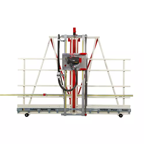

T33609 Safety Speed 7000M Vertical Panel Saw
The heavy duty induction motor allows you to cut endlessly.
The T33609 Safety Speed 7000M Vertical Panel Saw gives you that extra motor efficiency with little to no maintenance required.
The longevity of this machine is made possible by a high induction motor supported by US precision machined components.
The 7000M Panel Saw cuts horizontally and vertically, within .015” straight and square, up to 2” thick.
Shops with multiple operators and continuous cutting operations will see a strong return on investment with this machine.
Contact Safety Speed regarding technical support and their manufacturer warranty.
Please note: This item has a lead time of two weeks from time of order.
Due to product size, this item must be delivered to a loading dock or unloaded with a forklift. Liftgate service is not available.
Orders shipping outside of the lower 48 states will require a special quote.
  • Weight: 950 lbs.
  • Dimensions: 124" x 42" x 95"
  • Maximum crosscut: 64"
  • Maximum rip cut: unlimited
  • Cut Depth: 2"
  • Cut Accuracy: 1/64"
  • Frame Length: 120"
  • Daily usage: Continuous (8+ hours)
  • Rollers: 14
  • Saw blade diameter: 8"
Features:
  • 3HP, 3 ~ 230V motor
  • Heavy-Duty welded steel frame
  • Low voltage switch protection
  • Saw blade
  • Vertical and horizontal rulers
  • Quick change from vertical to horizontal cutting
  • Integrated stand
  • Solid aluminum rollers
  • Dust collection ready
  • Hold down bar
  • Enclosed counterweight
  • Quick stop gauges with stop block
  • Floating pressure saw foot
  • Wheels
