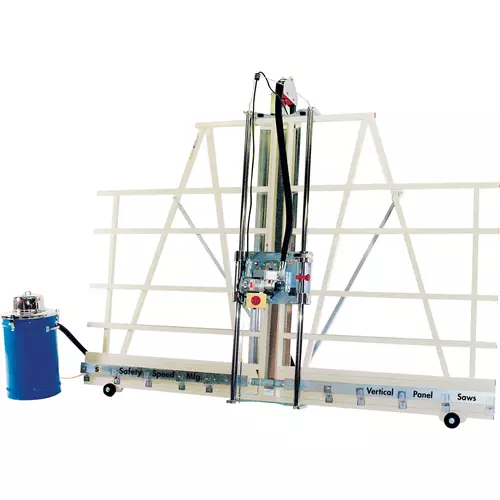

T33600 Safety Speed 6400 Vertical Panel Saw
Higher production cutting with a heavy duty worm driven motor.
The T33600 Safety Speed 6400 Vertical Panel Saw provides a 64" crosscut with an unlimited rip cut.
The 6400 panel saw features additional steel welded at a diagonal plane adding significant weight to the frame, a weighted pulley system for pulling the saw motor up and down the guide tubes vs a spring loaded counter balance, and additional bearings within the motor providing a tighter cutting tolerance.
Photos are shown with a stand, wheels, and a dust kit, which are optional accessories.

  • Weight: 598 lbs.
  • Dimensions: 124" x 17" x 92"
  • Maximum crosscut: 64"
  • Maximum rip cut: Unlimited
  • Cut Depth: 1-3/4"
  • Frame length: 120"
  • Saw blade diameter: 8"
  • Motor amps and volts: 13 amps, 120V
Features:
  • 3 hp worm driven heavy-duty saw motor
  • 10' welded steel frame
  • Chrome-plated 1 3/4" guide tubes
  • 8 nylatron roller bearing system
  • Adjustable vertical and horizontal rulers
  • Quick change from vertical to horizontal cutting
  • Thin material pressure guard
  • Solid aluminum material rollers
  • Enclosed counterweight system
  • Integrated dust collection bonnet
