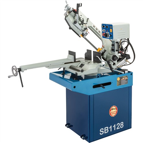

SB1128 7" x 9-3/8" 1 HP Metal-Cutting Bandsaw
Horizontal swivel-mast bandsaw designed for professional metal shops.
With a 1 HP motor and variable speed, this heavy-duty South Bend Tools metal-cutting bandsaw offers power and control for consistently perfect cuts.
Its robust swivel mast let you adjust the blade angle from 45° left and 60° right without repositioning your workpiece.
And, with other features such as a cutting fluid system, dual-position vise, and automatic blade shut-off, this bandsaw is ready for your manufacturing, automotive, and specialty projects.
  • Adjustable Downfeed Speed: Get exacting control on every cut for optimum performance.
  • Stand with Integrated Water Pan: Collects chips and excess cutting fluid to keep your shop efficient, clean, and safe.
  • Swivel Mast: Left-to-right movement accommodates angled cuts without repositioning material.
  • Built-In Cutting Fluid System: Continuous blade lubrication reduces friction and heat for improved cuts and extended blade life.
  • Dual-Position Vise: For clamping materials at different angles to maximize cutting precision.
  • Adjustable Work Stop: Allows repeat cuts of the same length for production runs.
  • Double Ball-Bearing Blade Guides: Ensure precise blade alignment and support during cuts.
  • Centralized Control Panel: All controls in one convenient spot for simple access and essential safety.
  • Feed Support Bracket: Easily handle long workpieces for stable, precise cuts.
  • Automatic Blade Shut-Off: Stops the blade automatically at the end of a cut to prevent overrun and reduce wear.
  • 2-Year Warranty: The reliability of South Bend machines is backed by a 2-year warranty.
  • Main Motor: 1 HP, 220V, single-phase, 3A
  • Pump motor: 1/8 HP
  • Blade size: 97" x 1"
  • Blade speeds: Variable, 55-255 FPM
  • Max. cutting height: 7"
  • Head swivel: Left 45°, Right 60°
  • Cutting capacities:
    • 90° Round 8-3/4"
    • 90° Rectangular 7" x 9-3/8"
    • 45° Round 5-5/8"
    • 45° Rectangular 4" x 5-5/8"
    • 60° Round 2-1/2"
    • 60° Rectangular 3-15/16" x 2-1/2"
  • Vise jaws: 5-1/2" H x 9-3/4" D
  • Floor to table height: 38-3/8"
  • Footprint: 33" x 24"
  • Dimensions: 59" W x 72-1/2" D x 73" H
  • Approx. shipping weight: 722 lbs.
This metal bandsaw offers the durability and safety you need for continuous metal cutting.
Get consistent results with the reliability of South Bend. Purchase the SB1128 7" x 9-3/8" 1 HP Metal-Cutting Bandsaw today!
