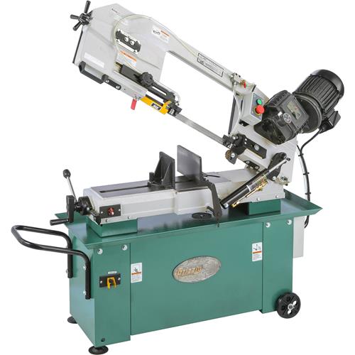

  • Motor: 1.5 HP
  • Cutting capacity - rectangular: 7 in.
  • Cutting capacity - round: 9 in.
  • Blade speeds: 148, 216, 282 FPM
  • Blade length: 104-1/2 in.
  • Head type: FIXED
  • Footprint: 40 in. x 16-1/2 in.
  • Overall height: 59 in.
  • Shipping weight: 467 lbs.
G9743 7" x 12" 1-1/2 HP Gearhead Metal-Cutting Bandsaw
A mobile metal-cutting bandsaw with great capacity and features.
The G9743 7" x 12" 1 HP Metal-Cutting Bandsaw was designed to cut 9" round and 7" X 12" rectangular metal stock.
The 104-1/2" x 1" blade rotates at three blade speeds of 148, 216, and 282 feet per minute.
The vise has a positive locking feature that improves productivity by opening the jaws just enough to slide material through.
The adjustable hydraulic downfeed allows maximizing the blade life.
Proper blade tension is also essential to long blade life, straight cuts, and efficient cutting. The blade tension indicator assist you with blade tensioning.
The G9743 has a built-in cutting fluid system that extends the life of your bandsaw blades by lowering the temperature of the blade and workpiece and washing away chips.
Additional features include the electrical control package, thermal protection right on the motor, a handle and wheels for moving the machine around, and three ball bearings per side on the blade guides!
For a full range of replacement blades for the G9743, shop here.
  • Motor: 1-1/2 HP, 110V/220V (prewired for 110V), single-phase, 18.6A/9.3A
  • Pump motor: 53W, 0.6A/0.3A
  • Blade size: 104-1/2" x 1"
  • Blade speed: 158, 213, 308 FPM
  • Cutting capacities:
    • 90° Round: 9"
    • 90° Rectangular: 7" x 12"
    • 45° Round: 6"
    • 45° Rectangular: 4" x 8"
    • 30° Round: 10"
    • 30° Rectangular: 8" x 10"
  • Vise jaw height: 5"
  • Vise depth: 9-3/4"
  • Table size: 7-3/4" x 18"
  • Floor to table height: 21-5/8"
  • Overall size: 56" W x 17-1/4" D x 59" H
  • Approximate shipping weight: 467 lbs.
  • Gear step blade speeds
  • Heavy-duty all steel, one piece base
  • Adjustable hydraulic downfeed
  • Adjustable blade guides
  • Automatic shut-off switch
  • Blade wheels have heavy-duty ball bearings
  • Magnetic safety switch
  • Coolant pump
  • Quick-release vise
