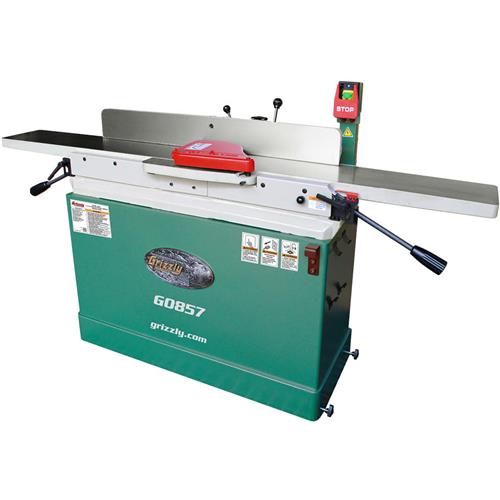

G0856 8" x 72" Jointer w/ Helical Cutterhead & Mobile Base
Ready to step up from your bench top model?
Step up from any 6" model you might be considering to this larger capacity helical cutterhead 8" jointer. The G0856 comes equipped with a 4-row helical cutterhead with 36 indexable carbide inserts that can each be rotated three times to expose a new, sharp edge.
The inserts slice through wood at an angle to achieve a sheering effect. You’ll get quieter operation, and most importantly, a significantly better finish with less tear-out using this cutterhead versus a straight-knife model.
This is like getting three knife changes with each set of inserts—which also don't require the finicky adjustment and setup that knives do. You'll save valuable time and money from the start.
The extra-long, 72" cast-iron bed with rabbeting table slides on dovetail ways for smooth and accurate table adjustments. Setting cut depth is a breeze for traditional jointing or rabbeting with the infeed and outfeed handwheels.
The H9893 replacement inserts are available when the stock inserts get dull.
It comes with a 1-year warranty which covers parts and assures the unit is free from factory defects.
The G0856 manual was written by our U.S.-based Technical Documentation Department and is packed with useful information. The complete and easy-to-read manual makes it easier to assemble and maintain your jointer.
Parts ship from the Grizzly parts warehouse in Springfield, MO.
CSA certified
  • Motor: 3 HP, 230V, single-phase, 12A
  • Maximum width of cut: 8"
  • Maximum depth of cut: 1/8"
  • Maximum rabbeting depth: 1/2"
  • Cutterhead diameter: 3-1/16"
  • Cutterhead type: 4-Row helical with 36 inserts
  • Insert size, type: 15 x 15 x 2.5mm, indexable carbide
  • Cutterhead speed: 5500 RPM
  • Table size: 9" x 72"
  • Fence size: 38" L x 4-5/8" H
  • Minimum stock length: 10"
  • Dust port size: 4"
  • Footprint: 17" x 23-1/2"
  • Overall dimensions: 72-1/2" W x 25-1/2" D x 42" H
  • Approximate shipping weight: 450 lbs.
  • Extra-long 72" bed with rabbeting table
  • Dovetailed-ways tables with handwheel adjustment and depth gauge
  • Precision-ground cast-iron tables
  • Center-mounted, precision-ground cast-iron fence with rack-and-pinion lateral adjustment
  • Fence stops at 45°, 90°, and 13°
  • Pedestal-mounted power switch with large shut-off paddle
  • Built-in mobile base with internally-mounted, non-directional casters
  • Sealed and permanently lubricated bearings
  • 5 replacement indexable carbide inserts included
