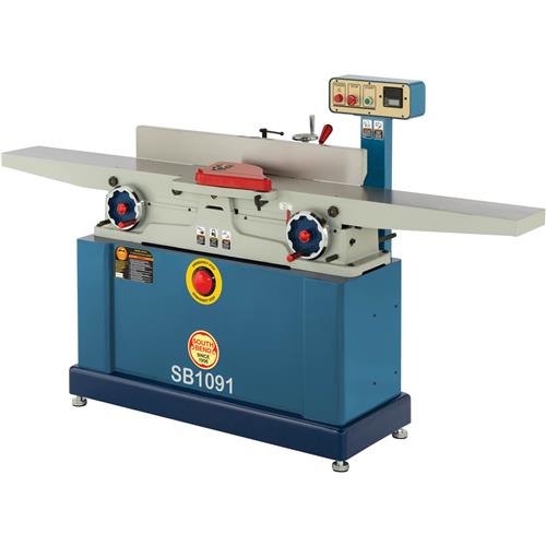

South Bend SB1091 8" x 83" Parallelogram Jointer with Helical Cutterhead
The parallelogram adjustment equals perfect alignment.
A 4-row helical cutterhead of the SB1091 8" Parallelogram Jointer ensures a cutting edge slightly angled for shearing action is always in contact with your workpiece. This provides the smoothest, flattest finish possible, whether surface planing or edge jointing.
The 36 indexable carbide inserts can each be rotated up to three times to expose a new sharp edge, meaning no sharpening or replacing knives every time an edge becomes dull or nicked.
The parallelogram table setup - where each table is mounted on four pivot points - allows for the smoothest, most precise table alignment possible.
Set the table height with dead-on accuracy with the digital readout for infeed table height and handwheel adjustment for both tables.
Other great features, such as a large emergency stop button on the cabinet stand below the cutterhead for safety and center-mounted cast-iron fence with rack-and-pinion lateral adjustment, make this South Bend jointer truly top-of-the-line!
