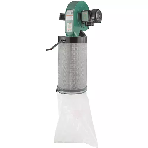

G0944HEP 1-1/2 HP Wall Mount Dust Collector with HEPA Filter
Trap fine sawdust with this HEPA filter-equipped wall-mount dust collector.
Known as "The Cub", the G0944HEP 1-1/2 HP Wall Mount Dust Collector with HEPA Filter is the dust collection system for all your small shop needs.
The easy-to-hang French cleat-style mount makes hanging this unit quick and clears up your floor space allowing for more room in a small shop.
The pleated canister filter catches smaller particle sizes down to 0.3-micron, with a MERV-17 rating at 99.97%.
The built-in filter cleaning handle knocks all those fine particles free from the pleats directly into the included plastic bag for the ultimate ease of use and disposal.
The G0944HEP comes with a handy ON/OFF remote, so you can control the unit from anywhere in the shop.
