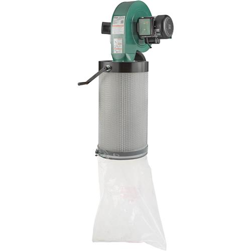

  • Motor: 1.5 HP
  • Airflow capacity: 1280 CFM
  • Impeller size: 12-3/4 in.
  • Filtration: 99.97% of 0.3 Micron
  • Filter size: 14-1/2 in. x 28 in. canister
  • Intake port(s): 2 x 4 in.
  • Sound rating: 75 - 77 dB
  • Overall height: 77-1/2 in.
  • Shipping weight: 77 lbs.
Hover to View 1-1/2 HP Wall Mount Models
G0944HEP 1-1/2 HP Wall Mount Dust Collector with HEPA Filter
Trap fine sawdust with this HEPA filter-equipped wall-mount dust collector.
Known as "The Cub", the G0944HEP 1-1/2 HP Wall Mount Dust Collector with HEPA Filter is the dust collection system for all your small shop needs.
The easy-to-hang French cleat-style mount makes hanging this unit quick and clears up your floor space allowing for more room in a small shop.
The pleated canister filter catches smaller particle sizes down to 0.3-micron, with a MERV-17 rating at 99.97%.
The built-in filter cleaning handle knocks all those fine particles free from the pleats directly into the included plastic bag for the ultimate ease of use and disposal.
The G0944HEP comes with a handy ON/OFF remote, so you can control the unit from anywhere in the shop.
Note: Machines manufactured prior to 01/2024 to use T24268 Replacement Bags. Machines manufactured since use T27900 Replacement Bags.
