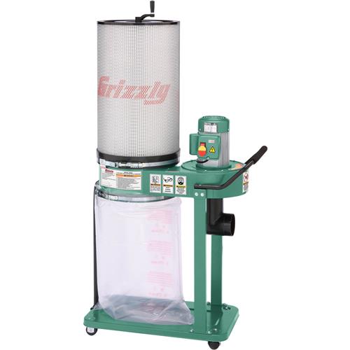

Grizzly G0583Z - 1 HP Canister Dust Collector
4.4 (38)
$530.00
  • Motor: 1 HP
  • Airflow capacity: 800 CFM
  • Impeller size: 10 in.
  • Filtration: 1 Micron
  • Filter size: 14-1/2 in. x 23-5/8 in. canister
  • Intake port(s): 1 x 4 in.
  • Sound rating: < 85 dB
  • Overall height: 59 in.
  • Shipping weight: 74 lbs.
G0583Z 1 HP Canister Dust Collector
Simply turn the top handle to clean the canister filter.
The G0583Z 1 HP Canister Dust Collector is designed to capture dust and wood chips from woodworking machines such as table saws, jointers, and planers.
The air drawn in by the 10", cast aluminum impeller and is filtered before it returns to your workspace.
The 1-micron pleated filter catches fine particles and the built-in filter cleaning handle knocks all those fine particles free from the pleats directly into the included plastic bag, ensuring you always have maximum air flow.
Rolling casters and push handle make this Canister Dust Collector the go-to machine for all the dust producing equipment in your shop.
The G0583Z manual was written by our U.S.-based Technical Documentation Department and is packed with useful information. The complete and easy-to-read manual makes it easier to assemble and maintain your dust collection system.
CSA certified
  • Motor: 1HP, 120V/240V (prewired for 120V), single-phase, 9A/4.5A
  • Max static pressure: 6.4"
  • Filtration: 1-Micron
  • Collection capacity: 15.7 gallons (2.1 cu. ft.)
  • Intake hole size: 4"
  • Impeller: 10", cast aluminum, radial fin
  • Lower bag size: 14-1/2" x 22"
  • Overall dimensions: 30-3/4" W x 15-3/4" D x 59" H
  • Approximate shipping weight: 74 lbs.
FEATURES
  • 1-Micron canister filtration
  • 10" Cast-aluminum impeller
  • Steel base with casters for mobility
  • Green powder coated paint
  • Clear plastic collection bag with quick clamp
  • Canister filters have six times the filtering area of regular bags
  • Turn the handle on the top a half turn for simple cleaning of the canister
  • Handle controls three cleaning flappers inside and shakes the dust from the filter
  • Fine dust from filter falls directly into the collection bag
  • 1-year limited warranty
The replacement T23129 Upper Canister and T24268 Lower Bag are also available.
