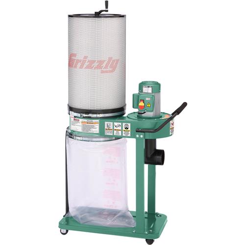

G0583Z 1 HP Canister Dust Collector
Simply turn the top handle to clean the canister filter.
The G0583Z 1 HP Canister Dust Collector is designed to capture dust and wood chips from woodworking machines such as table saws, jointers, and planers.
The air drawn in by the 10", cast aluminum impeller and is filtered before it returns to your workspace.
The 1-micron pleated filter catches fine particles and the built-in filter cleaning handle knocks all those fine particles free from the pleats directly into the included plastic bag, ensuring you always have maximum air flow.
Rolling casters and push handle make this Canister Dust Collector the go-to machine for all the dust producing equipment in your shop.
