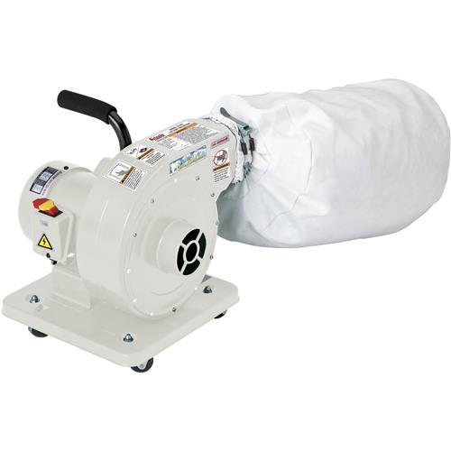

G1163P 1 HP Light-Duty Dust Collector
Effective dust collection not only keeps your shop cleaner and more pleasant to work in, but it can also help reduce your overall exposure to dust.
The G1163P 1 HP Light-Duty Dust Collector is a point-of-use dust collector, which is designed to capture dust and wood chips from one woodworking machine at a time, such as a table saw, jointer, or planer.
It is small in size and has a low profile that make this a perfect point-of-use, dedicated dust collector.
The air drawn in by the 10" cast aluminum impeller is filtered through a cloth collection bag that can be removed and emptied when full.
The bag filtration is rated at 30 micron, which for a visual comparison, is about half the width of a human hair. This is smaller than the threshold the human eye can see.
The G1163P is intended for single machine use. When the unit is not in use, it can be unplugged, unconnected, and rolled away on its convenient casters.
A carrying handle was designed to assist move the dust collector to and from where you will be using and storing it.
When it's not possible to plumb your shop with a full dust collection system, put one of these next to every machine instead!
Like all Grizzly dust collectors, the G1163P comes with a one-year warranty.
The complete and easy-to-read G1163P manual was written by our U.S.-based Technical Documentation Department and is packed with useful information.
Parts for the dust collector may be available online and shipped from the Grizzly parts warehouse in Springfield, MO.
CSA certified
  • Motor size: 1 HP, 120V/240V (prewired for 120V), single-phase, 7A/3.5A
  • Air suction capacity: 537 CFM
  • Intake hole size: 4"
  • Static pressure: 7.2"
  • Impeller: 10", Balanced cast aluminum, radial fin
  • Bag size (diameter x depth): 13-1/2" x 24"
  • Material collection capacity: 11-gallon
  • Bag Filtration: 30-Micron
  • Footprint: 14" x 14"
  • Overall dimensions: 44 W x 18" L x 19-1/2" H
  • Approximate shipping weight: 50 lbs.
  • 30-Micron bag filtration
  • 10" Cast aluminum impeller
  • Steel base with casters for mobility
  • White powder coated paint
Optional bag upgrade to 3-micron filtration with the H4340.
