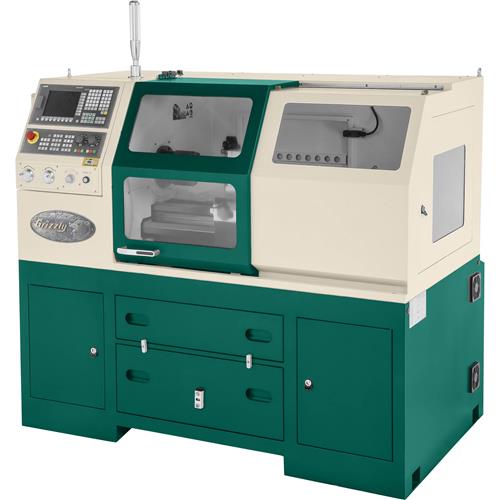

G0884 13" CNC Lathe with Auto Tool Changer
Take your shop's turning capabilities to the next level with the G0884 13" CNC Lathe with Auto Tool Changer.
The precision attained with a CNC makes perfect duplication for mass production a reality.
The G0884 is driven by a powerful 4 HP motor capable of spinning the A2-4 precision spindle at speeds from 30–4000 RPM.
Decrease cycle times thanks to the 6-position automatic tool changer and rapid speeds over 300 in./min.
The tailstock features an MT3 taper and 4-1/2" of travel.
Dramatically increase tool life thanks to the built-in 14-gallon coolant tank and flex nozzle.
The fully-enclosed work center ensures a clean work environment while maximizing coolant flow.
The G0884 manual was written by our U.S.-based Technical Documentation Department and is packed with useful information. The complete and easy to read manual makes it easier to assemble and maintain your lathe.
  • Main motor: 4 HP, 220V, 3-phase, 6.4A
  • Swing over bed: 13"
  • Swing over tool rest: 6"
  • Distance between centers: 27"
  • Maximum tool bit size: 5/8"
  • Spindle speed: Variable, 30–4000 RPM
  • Spindle: A2-4
  • Tailstock barrel taper: MT3
  • Tailstock barrel travel: 4-1/2"
  • Carriage travel: 23-1/2"
  • Cross slide travel: 6-1/4"
  • X-axis rapid speed: 235 in./min.
  • Z-axis rapid speed: 315 in./min.
  • Coolant capacity: 8 gallons
  • Footprint: 67" x 75"
  • Overall dimensions: 75" W x 47" D x 83" H
  • Approximate shipping weight: 3100 lbs.
  • 6-Position automatic tool changer
  • Siemens® Sinumerik CNC controller
  • Variable-speed A2-4 precision spindle
  • Servo motors with ball screws on all axes
  • Powerful 4 HP main motor
  • 1-year limited warranty
