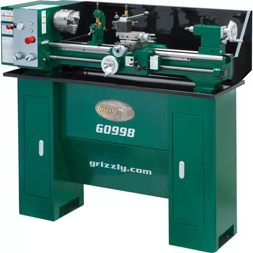

G0998 10" x 30" Variable-Speed Metal Lathe
Mid-sized metal lathe with modern design and impressive features.
This variable-speed metal lathe has the capacity to quickly turn out custom parts, repair tools, and complete unique DIY projects. The lathe's size makes it ideal for turning, facing, knurling, and treading, while being compact enough to fit in a small workshop.
Versatility is key with this machine – it offers features ranging from a mirrored digital display, powered cross slide and carriage, variable-speed, reversible spindle, outboard spindle spider for supporting long shafts, and more. It offers adaptability with a quick-change tool post and includes a sturdy stand with built-in storage.
This feature-rich metal lathe will give you professional results in a small space. Check out the list of features and specs below and take your metalworking to a new level.
KEY FEATURES & BENEFITS:
  • Mirror-Finish Digital Display: Simple-to-read, backlit display with a mirrored appearance when the machine is off; monitor spindle speed for quick adjustments as needed.
  • Powered Cross Slide & Carriage: Provides consistent, precise feed rates for faster production and less operator fatigue.
  • Variable-Speed Spindle: Offers convenient variable speed for adaptability based on material type and project needs.
  • Reverse Operation: Allows you to easily turn both right- and left-hand threads.
  • Outboard Spindle Spider: Helps to securely hold long or thin work pieces by providing additional grip and stability. This option is often only found on gunsmithing lathes.
  • 100-Series Quick-Change Tool Post: Includes three tool holders for fast, simple tooling changeouts.
  • Hardened & Ground V-Way Bed: Strong and stable v-way bed for even load distribution and accuracy for every lathe process.
  • Backsplash & Chip Tray: Run the full-length of the machine to prevent chips and coolant from getting spread around your shop.
  • Oil-Bath Gearbox: Continued lubrication of gears and bearings reduces wear.
  • Additional Storage: Cabinets and shelves are conveniently located in the stand.
  • Main motor: 1-1/2 HP, 120V, single-phase, 10.6A
  • Swing over bed: 10"
  • Swing over saddle: 9"
  • Swing over cross slide: 5-1/2"
  • Distance between centers: 29-1/2"
  • Bed width: 5-3/8"
  • Spindle type: Intrinsic back plate
  • Spindle bore: 1"
  • Spindle taper: MT#4
  • Tailstock taper: MT#2
  • Tailstock quill travel: 2-1/2"
  • Cross slide travel: 4-5/8"
  • Compound travel: 2-5/8"
  • Maximum tool bit size: 3/8"
  • Spindle speeds: Variable, 100–2200 RPM
  • Leadscrew: 3/4" x 16 TPI
  • Longitudinal feeds: (23) 0.0036 - 0.0183 in./rev.
  • Range of threads (inches, RH / LH): 8 - 56 TPI
  • Range of threads (metric, RH / LH): 0.35 - 3mm
  • Footprint: 46-1/2" x 12"
  • Overall dimensions: 56-1/2" W x 24" D x 48" H
  • Approx. shipping weight: 464 lbs.
INCLUDES:
  • 5" 3-Jaw & 4-jaw chucks
  • Steady & follow rests
  • 8-5/8" faceplate
  • MT#2 & MT#4 dead centers
  • MT#2 drill chuck 1 - 13mm B16
The G0998 10" x 30" Variable-Speed Metal Lathe equips even beginners to turn out high-quality projects.
