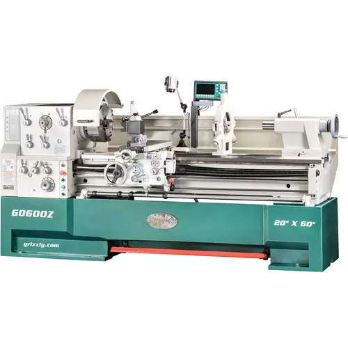

G0600Z 20" x 60" 3-Phase Big Bore Metal Lathe
An industrial metal lathe for precision turning, facing, and boring.
This massive 10 HP big bore lathe with full capacities is equipped to meet your production machining needs. The X-and Z-axis digital readout (DRO) gives you exact measurements for the carriage and cross-slide positioning, and durable Meehanite® castings provide stability with minimal vibration. This industrial lathe's quick-change gearbox reduces setup times, and an adjustable apron clutch makes it easy to modify torque.
To ensure continued efficiency, this metal lathe includes centralized lubrication and a coolant system, and it is equipped with a foot brake, chuck guard, and leadscrew cover for operator safety.
FEATURES AND BENEFITS:
  • X- & Z-Axis Digital Readout: Increases efficiency by reducing errors that can result from manual readings.
  • Meehanite® Bed Casting: Strong and wear-resistant lathe bed stands up to the challenge of fast-paced machining environments.
  • Universal Quick-Change Gearbox: An enclosed universal gearbox for cutting inch, metric, modular, and diametrical pitches.
  • Adjustable Apron Clutch: Control the feed speed and cutting pressure during machining, including during long, continuous cuts.
  • Centralized Lubrication System: Hardened and precision-ground headstock and apron gears and bearings are well-oiled for efficiency at any speed.
  • Coolant System: Protects the lathe’s cutting tools and your workpieces and allows for faster machining speeds.
  • Chuck Guard w/ Micro Switch: Offers protection from flying particles that result from lathe operations.
  • Leadscrew Cover: Keeps debris from accumulating on the leadscrew, preventing wear and damage.
  • Foot Brake: Immediately cuts power to the motor and stops the spindle from turning; for best use first turn the spindle lever off before stepping on the brake.
  • Motor: 10 HP, 220V, 3-phase, 26.4A
  • Coolant motor 1/8 HP, 0.5A
  • Swing over bed: 20"
  • Distance between centers: 60"
  • Swing over saddle: 12"
  • Swing over cross slide: 12"
  • Spindle bore: 3.15"
  • Spindle nose taper: MT#7
  • Spindle nose: D1-8 camlock
  • Spindle speeds: 12, 25–1600 RPM
  • Tailstock barrel taper: MT#5
  • Tailstock barrel travel: 7-1/4"
  • Cross slide travel: 12-3/4"
  • Compound travel: 5"
  • Range of threads (inches): 60 @ 2–112 TPI
  • Range of threads (metric): 47 @ 0.2–14 mm
  • Diametrical pitch range: 50 @ 4–112 DP
  • Modular pitch range: 39 @ 0.1–7 MP
  • Footprint: 110-1/2" x 26"
  • Overall dimensions: 111" W x 46-1/2" D x 65" H
  • Approximate shipping weight: 5758 lbs.
STANDARD EQUIPMENT:
  • 12" 3-Jaw scroll chuck
  • 13-3/4" 4-Jaw independent chuck
  • 17-3/4" Faceplate
  • Thread dial
  • 4-position auto apron stop
  • Full length splash guard
  • Dual inch/metric dials
  • (4) Quick-change tool holders
  • (2) MT#5 Dead centers & MT#7-5 tapered spindle sleeve
  • Steady rest w/rollers
  • Follow rest
  • LED work light
Get a high-powered, precision metalworking lathe for your demanding shop with the G0600Z 20" x 60" 3-Phase Big Bore Metal Lathe.
Grizzly owner's manuals and instruction sheets are produced by our U.S.-based Technical Documentation Department and are packed with useful information. Parts may be available online and are shipped from the Grizzly parts warehouse in Springfield, MO.
Need help? We offer U.S.-based customer service and technical support to get your questions answered and help keep your equipment running in top condition. And to ensure your satisfaction, the G0600Z comes with a 1-year warranty.
