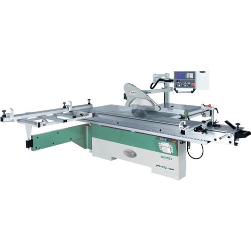

G0853 14" 10 HP 3-Phase Sliding Table Saw with DRO and CNC Fence
An easy-to-use, high-capacity sliding table saw.
Save time and money in your production shop with the power and control of the G0853 14" Sliding Table Saw. It was designed top-to-bottom for high-output production shops starting with its powerful 10 HP motor.
The digital blade controls and programmable CNC rip fence maximize time savings and provide consistency. Safety and ease of operation are also factored in with dual operation stations—one on the right side of the table for when using the rip fence, and one on the left for when using the slider.
The sliding table has a full 134" of crosscutting space and the rip fence allows a 51" rip—wider than a sheet of plywood! The scoring blade pre-scores the material, minimizing tear-out for a smooth, professional finish. The material then follows through the main blade for a clean, precise cut.
The overhead blade guard is enclosed and fully adjustable to maintain maximum protection around the saw blade with a 4" dust port. For busy shops who can't afford downtime, this machine will boost your production and pay for itself in no time.
The G0853 manual was written by our U.S.-based Technical Documentation Department and is packed with useful information.
*This machine is prewired for 220V. We can rewire to 440V in a few days’ time for a fee. Please contact Grizzly Technical Support at (570) 546-9663 before placing your order.
  • Main motor: 10 HP, 220V/440V* (prewired for 220V), 3-phase, 26A/13A
  • Scoring motor: 1 HP
  • Minimum circuit size: 40A @ 220V, 20A @ 440V
  • Rip capacity: 51"
  • Max. crosscut: 134" W x 121" L
  • Blade tilt: 0–45°
  • Max. depth of cut at 90°: 4"
  • Max. depth of cut at 45°: 2-3/4"
  • Main table size: 59" x 68"
  • Sliding table size: 15-5/8" x 126"
  • Main blade size: 14"/12"
  • Main blade arbor: 1"
  • Main blade speed: 3000, 4000, 5000 RPM
  • Scoring blade size: 4-3/4"
  • Scoring blade speed: 8000 RPM
  • Dust port sizes: 4", 5"
  • Floor space required: 271" W x 205" D
  • Footprint: 75" x 37"
  • Overall size: 133" W x 147" D x 66" H
  • Approximate shipping weight: 2176 lbs.
  • Digital controls for main blade height and tilt plus rip fence adjustment
  • Programmable CNC rip fence
  • Accepts 12" and 14" blades
  • Cross-slide table with locking clamp and hard chrome-plated slideway
  • Adjustable blade guard with built-in dust hood
  • Miter fence adjustable 30° left and 45° right
  • Scoring blade virtually eliminates tear-out
  • Sliding table on vertical guide system with precision bearing rollers
  • 1-year limited warranty
