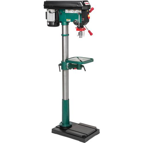

Grizzly T33902 - 14" Floor Drill Press with LED Light & Laser Guide
5.0 (1)
$589.00
MSRP: $655.00
You Save: $66.00 (10%)
Buy now! Sale Ends 1/1/26
  • Motor: 3/4 HP
  • Power Requirement: 120V, Single-Phase, 60Hz
  • Swing: 14 in.
  • Type: Floor
  • Range of Spindle Speeds: 340 - 2860 RPM
  • Drilling Capacity: 5/8 in.
  • Drill Chuck Type: JT3 Key Chuck
  • Quill Diameter: 1.847 in.
  • Shipping weight: 133 lbs.
T33902 14" 3/4 HP Floor Drill Press with LED and Laser
An affordable drill press with unique features and precision capabilities to maximize productivity.
This 14" floor option is a perfect choice for a beginner or an experienced hobbyist looking for a functional and economical drill press.
Whether you are countersinking, reaming, or performing other drilling steps, this press will be a valuable addition to your shop.
The 3/4 HP motor powers the spindle through twelve speeds from 340 to 2860 RPM and through 5/8" mild steel.
Use the crank handle to adjust the table vertically as needed for each project; the rack-and-pinion motion is smooth to prevent mistakes to your workpiece.
The LED light provides essential support during all drilling processes, increasing visibility to ensure accuracy every time.
With laser-line guides you can avoid costly errors during the drilling process and prevent wasted materials.
The push-button, heavy metal spindle depth stop allows for effortless adjustments and repeatable drilling.
Easily transport the drill press to other locations in your shop, or even to another site.
A durable floor drill press with the options you need to create eye-catching and functional projects.
The T33902 manual was written by our U.S.-based Technical Documentation Department and is packed with useful information.
Drill press parts may be available online and shipped from the Grizzly parts warehouse in Springfield, MO.
  • Motor: 3/4 HP, 120V, single-phase, 7.5A
  • Swing: 14"
  • Spindle taper: MT#2
  • Spindle travel: 3-1/4"
  • Spindle speeds: 12, 340–2860 RPM
  • Drill chuck: 1/8"–5/8", JT3
  • Drilling capacity: 5/8" mild steel
  • Maximum distance from spindle to table: 26-3/8"
  • Table dimensions: 11-1/4" x 11-1/4"
  • Table tilt: 0–45° left/right
  • Table swivel around column: 360°
  • T-slots: (x4) 9/16"
  • Footprint: 18" x 10-1/2"
  • Overall dimensions: 15" W x 25-1/2" D x 61-1/2" H
  • Approximate shipping weight: 133 lbs.
  • Crank handle-operated rack-and-pinion vertical table movement
  • Built-in LED light
  • Laser line guides
  • Flip-up chuck guard
  • Push-button spindle depth stop
  • Heavy-duty construction
  • 1-year limited warranty
