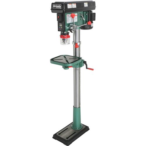

G0794 14" Floor Drill Press with Laser and DRO
A quiet and powerful floor drill press.
The G0794 14" Floor Drill Press with Laser and DRO features a digital spindle travel readout and laser pin-point accuracy for quickly aligning the workpiece to the drill entry point.
The powerful 3/4 HP motor features twelve speeds from 140 to 3050 RPM.
With a max drill capacity of 3/4" through steel, it can easily drill through fiberglass, plastic and composites.
The JT33 keyed drill chuck is fitted to the MT #2 spindle taper and offers up to 3-1/4" of travel. The chuck accepts drill bits from 3/64"–5/8". You can set the adjustable depth stop for predetermined and repeatable drilling.
The precision-ground cast-iron table is 11-3/8" x 11-3/8 and tilts 90° left and right. It swivels 360° around the steel column and has crossed 5/8" T-slots. It has crank handle operated rack-and-pinion vertical table movement. The table features locking levers and a coolant trough.
