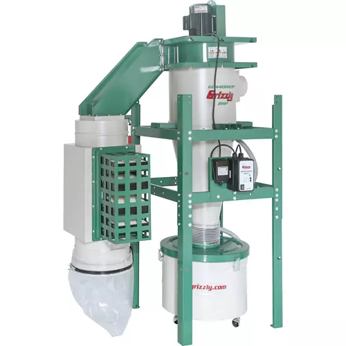

G0440HEP 2 HP Dual-Filtration HEPA Cyclone Dust Collector
The best of the best cyclone dust collectors!
This G0440HEP is the same unit as our G0440, but pre-equipped with the upgraded dual-filtration HEPA filter system! Our dual-filtration HEPA cyclones are geared toward those looking for the best filtration on the market.
The G0440HEP 2 HP Dual-Filtration HEPA Cyclone Dust Collector features a primary filter with efficiency of 99.9% at 0.2-2 microns. The secondary HEPA filter has an efficiency of 99.97% at 0.3 microns in size.
The advantage of this dual filtration setup is the majority of all fine dust is captured by the first filter. Only the finest dust makes it to the HEPA filter, resulting in up to a 900% increase in the life of the HEPA filter, potentially lasting up to 10 years!
Cyclonic action separates the heavy dust particles from the fine particles and drops them into the 35-gallon steel drum. The fine dust travels past the 14-1/2" diameter impeller and is then trapped by the cartridge filters made of spun-bond polyester. A clear plastic bag collects the fine cake that shakes off the filter for consistent dust collector performance.
Casters mounted to the drum make disposal of the larger chips and dust as easy as it gets.
