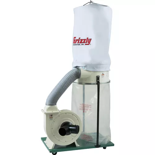

Grizzly G1029Z2P - 2 HP Dust Collector with Aluminum Impeller - Polar Bear Series

G1029Z2P 2 HP Dust Collector with Aluminum Impeller
Rid your shop of fine dust particles.
This 2 HP Dust Collector with Aluminum Impeller is designed to capture dust and wood chips from woodworking machines, such as table saws, jointers and planers.
The air drawn in by the dust collector is filtered before it returns to the workspace.
It features a 2.5 micron top bag to capture the fine dust particles that normally end up all over your shop.
The G1029Z2P has an air suction capacity of 1550 CFM and has a max static pressure of 11.0 in. Static pressure is produced by the 12-3/4" cast aluminum impeller to move the wood chips into the collector.
