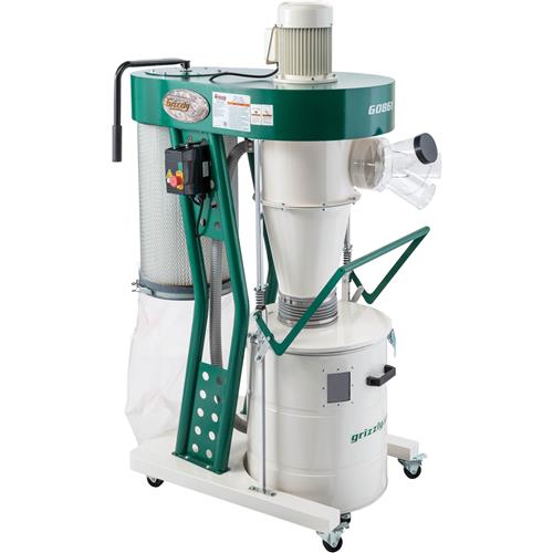

Grizzly G0861 - 2 HP Portable Cyclone Dust Collector

G0861 2 HP Portable Cyclone Dust Collector
Experience extreme dust collector power in a portable, compact profile!
The G0861 2 HP Cyclone Dust Collector brings big power in a portable, compact profile at an amazingly low price.
This cyclone dust collector creates a vortex of incoming air that extracts heavy wood chips and large dust particles into a plastic-bag-lined steel drum.
The remaining fine dust travels past the 12-3/4" aluminum impeller, is caught by a canister filter and then deposited in a separate plastic collection bag. The impeller is computer balanced to minimize vibration.
Handle up to 3 machines thanks to the massive 7" intake hole with three-way splitter and 1023 CFM of airflow capacity. Machines manufactured after 2021 feature a heavy-gauge clear plastic adapter that allows three 4" lines to be connected simultaneously. This allows for easy visibility and will help track down potential clogs.
Swivel casters for easy mobility and a wireless remote provide ultimate convenience.
The built-in crank handle for easy pleated filter cleanout. A few back-and-forth cranks with this handle and you're ready for the next job!
