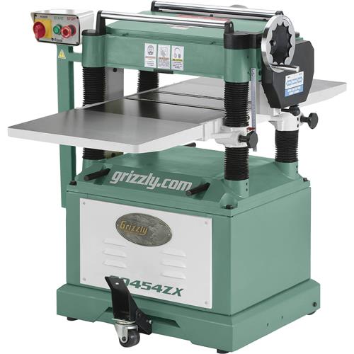

G0454ZX 20" Planer w/ Spiral Cutterhead
Experience precision with the G0454ZX 20" Planer, featuring a powerful 5 HP motor and a high-performance spiral cutterhead for impeccable results.
Cutting-Edge Spiral Cutterhead: This planer boasts a 4-row spiral cutterhead equipped with 98 indexable carbide inserts, ensuring a smooth and flawless surface finish on your workpieces.
Insert Rotation for Longevity: Each insert can be rotated up to three times, providing a fresh, sharp edge for consistently superior results over time.
High-Powered Performance: The 5 HP motor drives the cutterhead at 4902 RPM, allowing you to plane stock up to 20" wide and 8" thick with a depth of up to 1/16" per pass.
Exceptional Power Transmission: The triple V-belt drive delivers robust power transmission, stability, and the extra torque required for handling tough materials.
Effortless Operation: Achieve smooth and clean planer passes with the two-speed automatic board feed, adjustable bed rollers, and bed return rollers.
Mobility Meets Convenience: Equipped with a built-in mobile base, you can easily relocate this planer within your workshop as needed.
Additional Features: The G0454ZX planer also includes a cast-iron handwheel for depth adjustment, inch and metric measuring scales, and solid cast-iron extension wings.
When the time comes, the H7319 are the 14mm x 14mm x 2.0mm replacement inserts needed.
The G0454ZX manual was written by our U.S.-based Technical Documentation Department and is packed with useful information.
TUV certified
