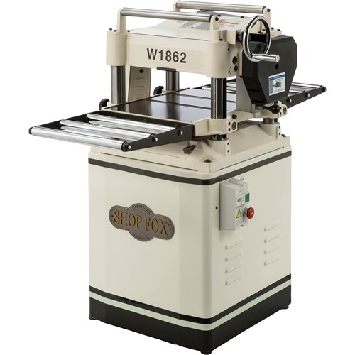

W1862 Shop Fox 15" 3 HP Planer
Produced in a factory renowned for innovation and dependability, this 15" Planer with a three-knife cutterhead has all the features you’d expect in a top-quality planer, but at a surprisingly affordable price.
Standard features include two-speed gear box with oil-bathed gears, magnetic switch with overload protection, precision-ground bed with bed rollers, board return rollers, and 4 heavy-duty support columns with dual table locks for rigid and accurate performance.
CSA certified
  • Motor: 3 HP, 240V, 15A, single-phase
  • Maximum cutting width: 15"
  • Maximum cutting height: 6"
  • Minimum stock thickness: 3/16"
  • Minimum stock length: 8"
  • Maximum depth of cut full width: 3/32"
  • Maximum depth of cut 6" wide board: 1/8"
  • Feed rate: 16 FPM & 28 FPM
  • Cutterhead diameter: 3"
  • Knives: 3 HSS (15" x 1" x 1/8")
  • Cutterhead speed: 5000 RPM
  • Infeed rollers: solid serrated steel
  • Outfeed rollers: knurled steel
  • Table size: 15" x 20"
  • Approximate shipping weight: 541 lbs.
  • Two-year warranty!!
  • Ball bearing infeed and outfeed extension rollers
  • Magnetic switch overload protection
  • Locking table
  • 4" Dust port
  • Triple V-belt driven cutterhead
  • 2-Speed chain-driven automatic feed rollers
  • Hardened anti-kickback fingers
  • CSA Certified
