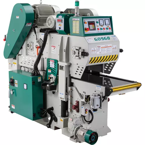

G0968 16" Double-Sided Planer
Streamline commercial planing operations by adding a solid cast-iron, double-sided planer to your shop!
Slash production time with a powerful machine that planes both sides of rough lumber at once.
With upper and lower spiral cutterheads powered by 15 HP and 10 HP motors respectively, this exceptional machine mills boards with dimensional consistency.
Insert changes are quick on the lower horizontal slide-out cutterhead - no extended delays needed for changeouts.
Digital positioning makes it simple to set or change board thickness and ensures precise results on every run.
The solid precision-ground, chrome-plated table withstands extensive use, and provides smooth feeding for years of efficient operation.
Auto lubrication and a one-shot table oiler simplify the maintenance process and extends the life of the machine.
This feature-packed double-sided planer also includes three steel bed rollers, two 5" dust ports, and a rear-outfeed emergency stop.
A high-production two-sided planer designed for busy commercial woodworking shops.
  • Required power source: 230V or 460V, 3-phase, min. 100A circuit 230V/50A circuit 460V
  • Upper cutterhead motor: 15 HP, 230V/460V (prewired 230V)
  • Lower cutterhead motor: 10 HP, 230V/460V (prewired 230V)
  • Feed motor: 2 HP
  • Headstock elevation motor: 1/2 HP
  • Maximum stock width: 15-3/4"
  • Maximum stock thickness: 7-7/8"
  • Minimum stock thickness: 5/16"
  • Maximum cutting depth planing full width: 5/32"
  • Maximum cutting depth planing 6" wide board: 1/4"
  • Cutterhead diameter: 4"
  • Cutterhead type: Spiral (2), with 60 inserts each
  • Cutterhead speed: 5000 RPM
  • Feed rate: Variable, 20–69 FPM
  • Table size: 86" x 16"
  • Dust port size: 5"
  • Overall dimensions: 40-1/2" W x 88-1/2" D x 70-1/2" H
  • Approximate shipping weight: 4531 lbs.
  • Dual spiral cutterheads, each with 60 indexable cutters
  • Two main motors for increased power
  • Quick-change lower slide-out cutterhead
  • Digital thickness positioning
  • Variable-feed speed control via digital inverter
  • Precision-ground, chrome-plated table surface
  • Automatic oiler for feed system lubrication
  • One-shot table oiler
  • Three steel bed rollers
  • Two 5" dust ports
  • Rear-outfeed emergency stop
