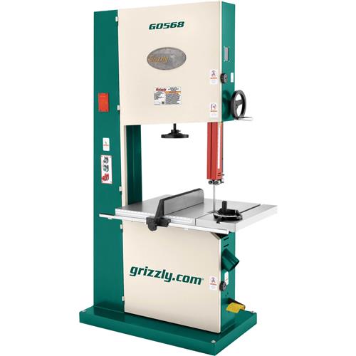

G0568 24" 5 HP Industrial Wood Bandsaw
An industrial bandsaw loaded with features not found in saws costing much more.
The 5 HP motor of the G0568 24" 5 HP Industrial Bandsaw powers through wood at a maximum 24-1/2" cutting capacity and the 16-1/4" resaw capacity is big enough for most applications.
The G0568 has an extra-wide 33-1/2" x 23-5/8" cast-iron table that can tilt 45° right, while also adding additional support to the table for those really big workpieces.
The ball-bearing blade guides ensure accurate cutting, and the quick-release blade tension makes changing blades a breeze.
The conveniently mounted foot brake, blade guard with scale, and removable safety key are features you will be glad to have. For a full range replacement and resaw blades for the G0568, shop here.
The G0568 manual was written by our U.S.-based Technical Documentation Department and is packed with useful information. The complete and easy-to-read manual provides full instructions on how to assemble and maintain your bandsaw.
  • Motor: 5 HP, 220V, single-phase, 23A
  • Throat (max. width left of blade): 24-1/2"
  • Resaw capacity: 16-1/4"
  • Table size: 33-1/2" x 23-5/8"
  • Table tilts 45° right
  • Floor-to-table height: 32-1/2"
  • Blade size: 180–181-1/2" long (1/4" to 1-1/2" wide)
  • Blade speed: 5300 FPM
  • Footprint: 41-3/8" x 23-1/2"
  • Overall dimensions: 48" W x 32" D x 83-1/2" H
  • Approximate shipping weight: 951 lbs.
  • Foot brake stop
  • Two built-in 4" dust ports
  • Quick-change blade release/tensioner
  • Rack-and-pinion table tilt mechanism
  • Blade height measurement scale
  • Ball-bearing blade guides provide rigid, positive side support
  • Sealed and lubricated bearings
  • Balanced cast-iron wheels
  • Convenient blade tension scale
  • Rack-and-pinion upper guide adjustment
  • Includes precision-ground cast-iron fence, 1" hook blade, and miter gauge
