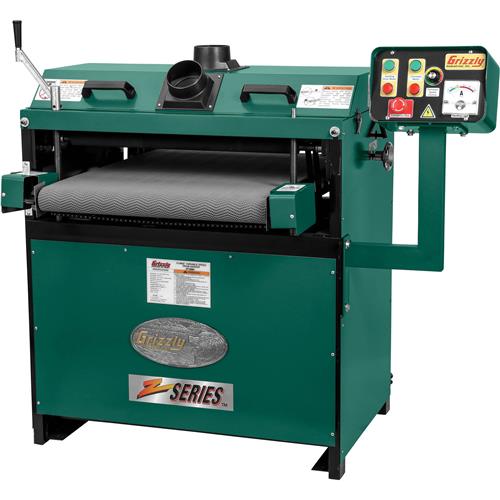

G1066Z 24" 5 HP Variable-Speed Drum Sander
Perfect sanding results in a fraction of the time.
The G1066Z features dual 6" aluminum sanding drums allow a coarse and fine sanding in one pass doubling the efficiency of a single drum sander so allowing you to work faster and be more productive.
The variable-speed feed from 0 to 20 feet per minute allows you to find the perfect feed rate for your sanding project.
The G1066Z accepts large materials, up to 4" thicknesses and 23-1/2" wide.
Wired to run on 220V, the 5 HP has all the power you will ever need to continuously sand large surfaces.
Customers have asked us why our drums are not rubber coated. The rubber-coated drums become "spongy" and do not sand evenly or parallel to the ends.
For your convenience, the G1066Z has an easy access control panel and built-in amp meter to gauge workload.
To keep the dust to a minimum, two 4" dust ports have been added for easy hook-up to a collection system.
The hook-and-loop sandpaper length needed is 3" wide by 176" long. A wide selection of replacement sanding rolls, from coarse grits for fast material removal to ultra-fine grits for a flawless, high-grit finish.
The G1066Z manual was written by our U.S.-based Technical Documentation Department and is packed with useful information.
  • Sanding motor: 5 HP, 220V, single-phase drum, 25A
  • Feed motor: 1/3 HP, 2A
  • Maximum board width: 23-1/2"
  • Minimum board width: 2"
  • Maximum board thickness: 4"
  • Minimum board thickness: 1/8"
  • Minimum board length: 9"
  • Drum surface speed: 2300 FPM
  • Conveyor feed rate: Variable, 0-20 FPM
  • Sandpaper type: 3" x 176" hook-and-loop
  • Footprint: Footprint: 34-1/2" x 24"
  • Overall dimensions: 50" W x 37" D x 44-1/2" H
  • Approximate shipping weight: 484 lbs.
  • Industrial-duty rubber conveyor belt
  • Two 4" dust ports for easy hook-up to a collection system
  • Variable-speed conveyor
  • V-belt main motor; chain drive feed motor
  • Dual 6" aluminum sanding drums
  • Four leadscrew table elevation system
  • State-of-the-art computer balanced drums
  • Easy-access control panel with amp load meter
  • External micro adjustment on outfeed drum
  • 1-year limited warranty
Please Note: If you are purchasing the D2058A Mobile Base for use on the G1066-series 24" Drum Sanders, you must also purchase the D2246A Extension Bars for the Mobile Base.
