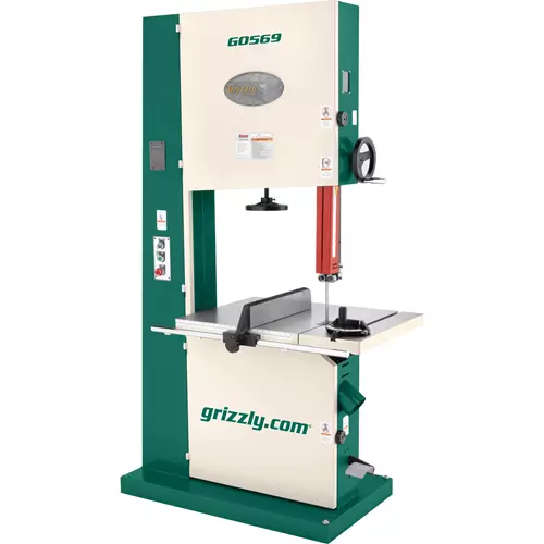

G0569 24" 7-1/2 HP 3-Phase Industrial Wood Bandsaw
Our 24" Industrial Bandsaws are loaded with features not found in saws costing much more.
You will appreciate the two 4" dust ports when you put the power and speed of this saw to the test.
The ball-bearing blade guides ensure accurate cutting and the quick-release blade tension makes changing blades a breeze.
Our exclusive rack-and-pinion table tilt makes accurate angle cuts easy, while also adding additional support to the table for those big workpieces.
The conveniently mounted foot brake, blade guard with scale and removable safety key are features you will be glad to have.

  • Motor: 7-1/2 HP, 220V/440V* (prewired 220V), 3-phase, 20A/10A
  • Minimum circuit size: 30A @ 220V, 15A @ 440V
  • Throat (max. width left of blade): 24-1/2"
  • Resaw capacity: 16-1/4"
  • Blade size: 180"–181-1/2" long
  • Blade width: 1/4"–1-1/2" wide
  • Blade speed: 5300 FPM
  • Table size: 33-1/2" x 23-5/8" x 2"
  • Table tilt: 0–45° right
  • Floor to table height: 34-1/2"
  • Table height with included riser: 34-1/2"
  • Footprint: 41-3/8" x 23-1/2"
  • Overall size: 48" W x 32" D x 83-1/2" H
  • Approximate shipping weight: 962 lbs.
  • Foot pedal brake
  • Two built-in 4" dust ports
  • Quick-change blade release/tensioner
  • Rack-and-pinion table tilt mechanism
  • Blade height measurement scale
  • Ball-bearing blade guides provide rigid, positive side support
  • Balanced cast-iron wheels
  • Convenient blade tension scale
  • Rack-and-pinion upper guide adjustment
  • Sealed and lubricated bearings
  • Precision-ground cast-iron fence
  • 1" hook blade
  • Miter gauge
